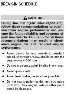

I know what the manual says, and it seems really excessive to me. Personally, I would think you would be set to go after 500 miles. What did you all do?

If you break in the Titan the same way as a Sentra, I bought one of those too, then for the first 1,000 miles you're not supposed to exceed 4,000 rpm in any gear and try not to drive at a constant speed either slow or fast. The pistons need time to be seated and racing the engine beyond the stated limit during the break in period could have adverse effects later on. Plus, you're not supposed to "wind up" the Endurance V8. It's a truck motor afterall, and it doesn't rev as freely and as easily as a 4 cylinder mill like the 2.5 liter motor in my '04 Sentra.

I'm at 1100 miles right now. I have not taken it over 4000 RPM,
(although I cannot wait to redline it at 6100 once I pass break in
period), not have I punched it.
I changed the original oil at 1000 miles to get the break in oil out.
I've adjusted the cruise on the highway drives at 70 for a bit, then
60, then 65, etc...just so I wouldn't drive the entire way at the same
speed.

| Posted: May 24 2004 at 1:15pm | IP Logged
Excerpt from the manual:
__________________ 2005 Titan LE Crew Cab 4X4
