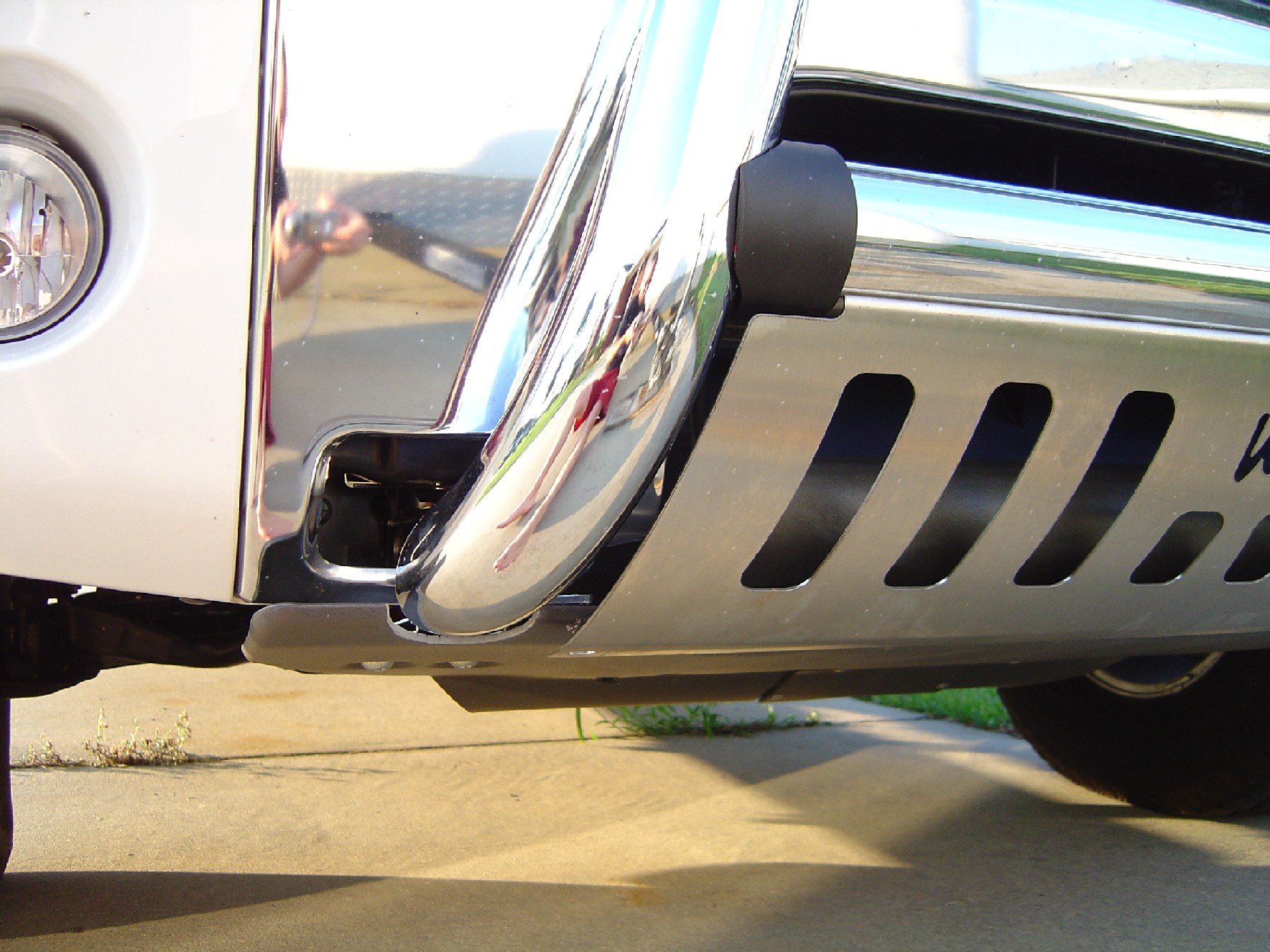

Anyone found a way to modify the factory off road skid plate to work with a Westin Bull Bar?

Yea,, I cut a U shape right where the bar goes and it fits great, You realy can't see the cut unless you get down on it.

I really appreciate the help (and the photos). Did you have to modify the front brackets that the skid plate and the factroy tow hooks attach to? I could not see how to get the brakets mounted along with the Bull bar so for now it is mounted direct and I left the brackets and the skid plate off.

The instructions came with mine. you put the bull bar in the spot the hooks went. There should have been a spacer, looks like a small piece of pipe, that goes over the bracket for the skid plate. It just bolts right back into place. You will have to play with it and get the bolts lined up before tighting it.
